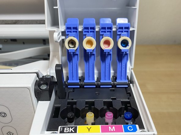

    • Open the ink cartridge case.
    Vraag FixBot
    Voeg opmerking toe
  6. How to Fix an Epson EcoTank ET-2850 Printer That Smudges Ink While Printing: stap 6, afbeelding 1 van 3 How to Fix an Epson EcoTank ET-2850 Printer That Smudges Ink While Printing: stap 6, afbeelding 2 van 3 How to Fix an Epson EcoTank ET-2850 Printer That Smudges Ink While Printing: stap 6, afbeelding 3 van 3
    • Open the latches for each individual color.
    Vraag FixBot
    Voeg opmerking toe
  7. How to Fix an Epson EcoTank ET-2850 Printer That Smudges Ink While Printing: stap 7, afbeelding 1 van 3 How to Fix an Epson EcoTank ET-2850 Printer That Smudges Ink While Printing: stap 7, afbeelding 2 van 3 How to Fix an Epson EcoTank ET-2850 Printer That Smudges Ink While Printing: stap 7, afbeelding 3 van 3
    • Match the color with the label assigned to it (either BK, Y, M, or C).
    • Refill the cartridge until the ink level reaches the top of the cartridge.
    • Refill the cartridge slowly so the ink doesn't spill into the printer.

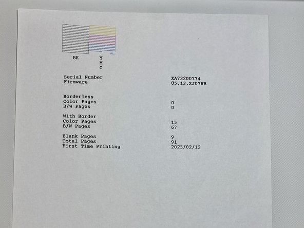

  14. How to Fix an Epson EcoTank ET-2850 Printer That Smudges Ink While Printing: stap 14, afbeelding 1 van 1
    • Once the printer is finished cleaning, it will automatically print out a piece of paper with the ink colors and other words on it.
    Vraag FixBot
    Voeg opmerking toe
  15. How to Fix an Epson EcoTank ET-2850 Printer That Smudges Ink While Printing: stap 15, afbeelding 1 van 1
    • If the colors and words on the paper are no longer smudged, then the issue is resolved.
