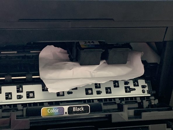

  3. How to Fix Paper Jam in Canon Pixma TR 4520, remove any paper visible from the front tray: stap 3, afbeelding 1 van 2 How to Fix Paper Jam in Canon Pixma TR 4520, remove any paper visible from the front tray: stap 3, afbeelding 2 van 2
    • open the front tray and take a look
  4. How to Fix Paper Jam in Canon Pixma TR 4520, if it is accessible with your hands, pull out paper slowly with both hands(avoid tearing): stap 4, afbeelding 1 van 1
    • If paper tears apart, remove whatever you can, we can fix the rest in the later steps

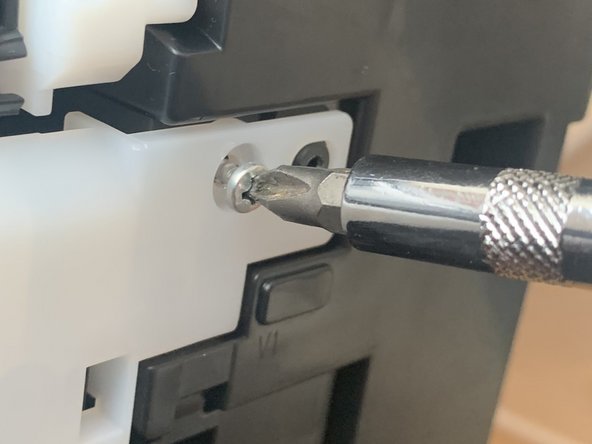

  6. How to Fix Paper Jam in Canon Pixma TR 4520, pick up home usage screwdriver with the head like shown on the picture: stap 6, afbeelding 1 van 3 How to Fix Paper Jam in Canon Pixma TR 4520, pick up home usage screwdriver with the head like shown on the picture: stap 6, afbeelding 2 van 3 How to Fix Paper Jam in Canon Pixma TR 4520, pick up home usage screwdriver with the head like shown on the picture: stap 6, afbeelding 3 van 3
    • Take a look at the shape

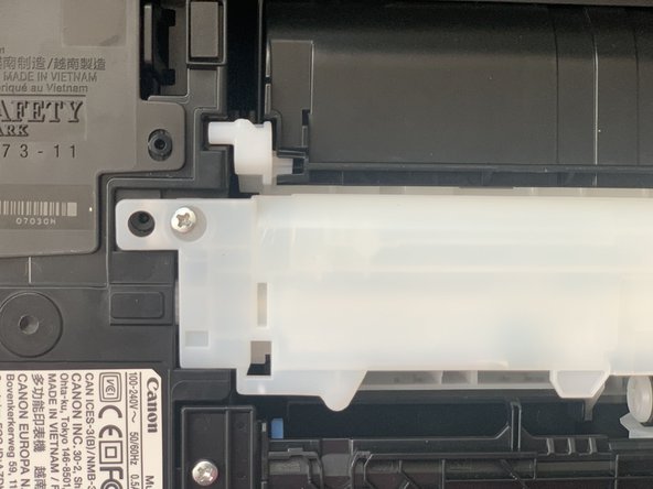

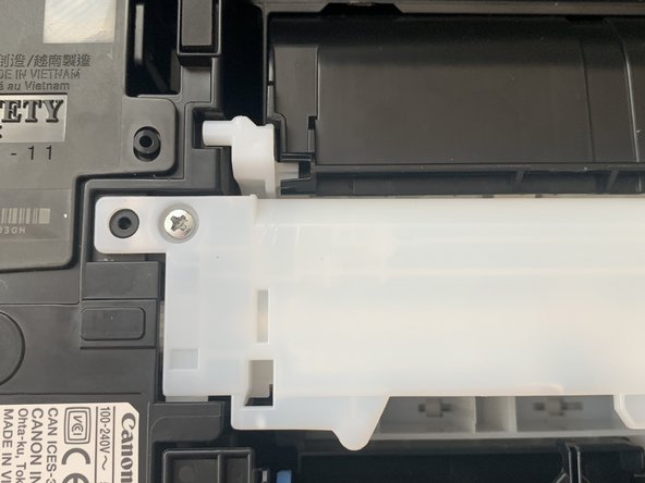

  7. How to Fix Paper Jam in Canon Pixma TR 4520, look for two silver screws that hold transport unit cover from the rear end: stap 7, afbeelding 1 van 2 How to Fix Paper Jam in Canon Pixma TR 4520, look for two silver screws that hold transport unit cover from the rear end: stap 7, afbeelding 2 van 2
    • look at the circle annotation
  8. How to Fix Paper Jam in Canon Pixma TR 4520, untwist the screw, turn the screw into counter clockwise ("loose" direction) and keep turning the screwdriver: stap 8, afbeelding 1 van 3 How to Fix Paper Jam in Canon Pixma TR 4520, untwist the screw, turn the screw into counter clockwise ("loose" direction) and keep turning the screwdriver: stap 8, afbeelding 2 van 3 How to Fix Paper Jam in Canon Pixma TR 4520, untwist the screw, turn the screw into counter clockwise ("loose" direction) and keep turning the screwdriver: stap 8, afbeelding 3 van 3
    • Move the screwdriver slowly until the screw comes off

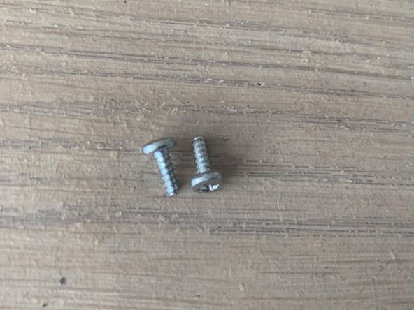

  9. How to Fix Paper Jam in Canon Pixma TR 4520, repeat for the second screw: stap 9, afbeelding 1 van 2 How to Fix Paper Jam in Canon Pixma TR 4520, repeat for the second screw: stap 9, afbeelding 2 van 2
    • Keep your screws in a safe place

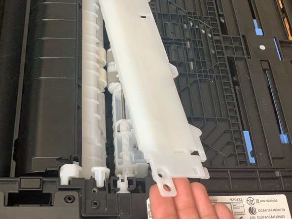

  10. How to Fix Paper Jam in Canon Pixma TR 4520, transport unit cover will become loose: stap 10, afbeelding 1 van 2 How to Fix Paper Jam in Canon Pixma TR 4520, transport unit cover will become loose: stap 10, afbeelding 2 van 2
    • Be gentle while removing the unit, you don't want to damage it

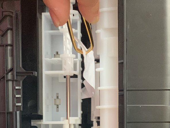

  11. How to Fix Paper Jam in Canon Pixma TR 4520, remove the transport unit and reveal jammed paper: stap 11, afbeelding 1 van 3 How to Fix Paper Jam in Canon Pixma TR 4520, remove the transport unit and reveal jammed paper: stap 11, afbeelding 2 van 3 How to Fix Paper Jam in Canon Pixma TR 4520, remove the transport unit and reveal jammed paper: stap 11, afbeelding 3 van 3
    Gereedschap gebruikt in deze stap:
    • Take it out with your hands or if it is hard to grab on, pick up tweezers
