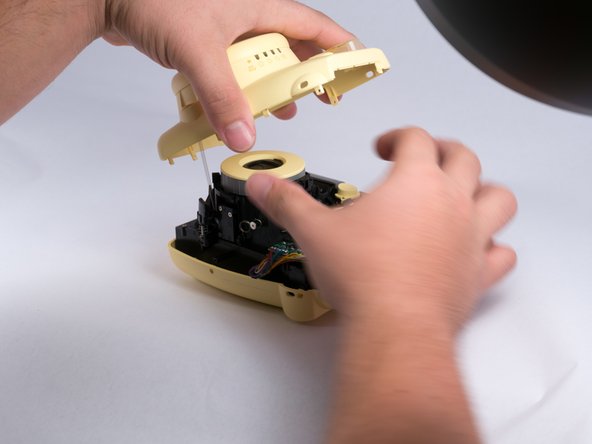

  4. Fujifilm Instax Mini 8 Infrared Blaster Replacement: stap 4, afbeelding 1 van 3 Fujifilm Instax Mini 8 Infrared Blaster Replacement: stap 4, afbeelding 2 van 3 Fujifilm Instax Mini 8 Infrared Blaster Replacement: stap 4, afbeelding 3 van 3
    • Once all screws are removed, gently pry open the front casing with your hands or plastic opening tools carefully. Do note that there will be a spring that attaches the front casing and the main circuit board, so refrain from allowing excess tension on the spring.
