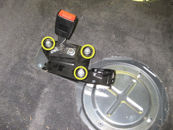

    • Remove the seatbelt bracket for the right side.
    • To do this, remove the three 10mm triple square bolts attaching the bracket to the floor.

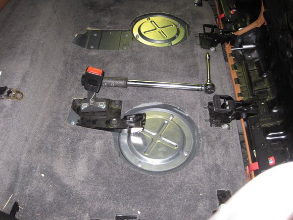

    • Using a 10mm socket, remove the 4 bolts that cover the gas tank access cover.
    • Remove the covers - on mine, the smell of gas was very much present now!
    • Do this on both sides of the vehicle.

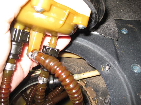

    • Look here! There's gas floating around on top of the driver's side. It also looks "clean" and shiny (compared to the passenger side).
    • Upon closer inspection (and a tip from Crazyhippy) the leak is at the top of the dome. Zooming in shows about a 1/8" crack seen in the pictures as a discoloration at the top of the dome.
    • When the fuel pump is on, the gas is flowing. Even after the pump stops, the gas keeps coming out (as I imagine the system is still under pressure).
    • VW part number for this assembly is 7L0 919 679. World Impex has a VDO equivalent (the original is made by VDO as well) for under $100. See here.

    • The fuel filter assembly has a tab to align it with the gas tank.
    • Remove the protective cover from the vent hose connection, but don't connect the vent hose yet.

  37. Fixing 2004-2010 Volkswagen Touareg Touareg Gas Leak: stap 37, afbeelding 1 van 2 Fixing 2004-2010 Volkswagen Touareg Touareg Gas Leak: stap 37, afbeelding 2 van 2
    • Install the passenger side seat belt mount.
    • VW states that the order of installation of these bolts is important. See the picture of the service manual for the order.
    • Torque these bolts to 20 Nm.
    • Notice there's only 3 bolts on this side.

  41. Fixing 2004-2010 Volkswagen Touareg Touareg Gas Leak: stap 41, afbeelding 1 van 3 Fixing 2004-2010 Volkswagen Touareg Touareg Gas Leak: stap 41, afbeelding 2 van 3 Fixing 2004-2010 Volkswagen Touareg Touareg Gas Leak: stap 41, afbeelding 3 van 3
    • Install the clip that retains the seat backs.
    • Install the Torx screw to retain the clip.
  42. Fixing 2004-2010 Volkswagen Touareg Touareg Gas Leak: stap 42, afbeelding 1 van 2 Fixing 2004-2010 Volkswagen Touareg Touareg Gas Leak: stap 42, afbeelding 2 van 2
