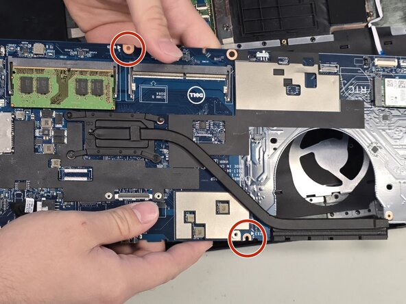

  13. Dell Latitude 5580 Motherboard Replacement: stap 13, afbeelding 1 van 2 Dell Latitude 5580 Motherboard Replacement: stap 13, afbeelding 2 van 2
    • Remove the remaining five screws holding the motherboard to the chassis.
    • With your hand, remove the motherboard from the chassis.
