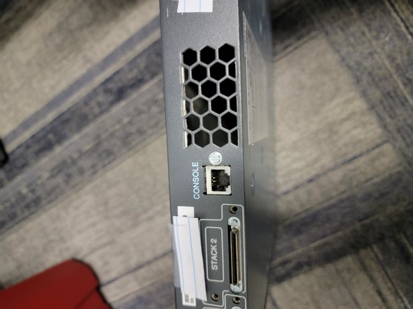

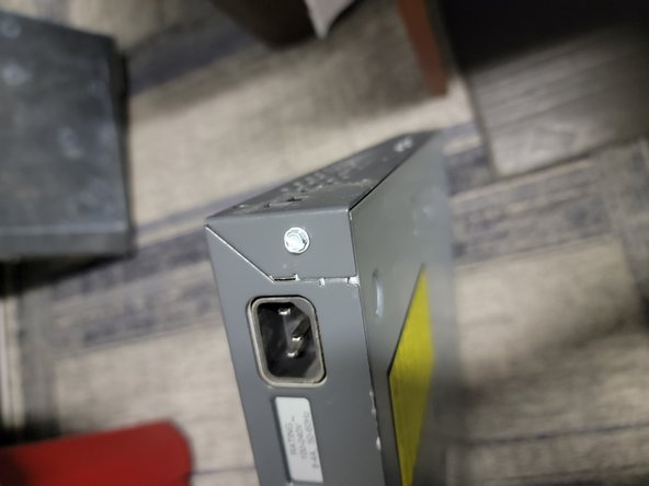

  4. Cisco Catalyst 2975 network switch cooling fan replacement, Remove back side screws: stap 4, afbeelding 1 van 3 Cisco Catalyst 2975 network switch cooling fan replacement, Remove back side screws: stap 4, afbeelding 2 van 3 Cisco Catalyst 2975 network switch cooling fan replacement, Remove back side screws: stap 4, afbeelding 3 van 3
    • Remove back side screws with flat head or hex head screwdriver. Total of four.

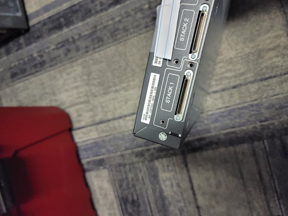

  5. Cisco Catalyst 2975 network switch cooling fan replacement, Remove back screws - continued: stap 5, afbeelding 1 van 2 Cisco Catalyst 2975 network switch cooling fan replacement, Remove back screws - continued: stap 5, afbeelding 2 van 2
    • Remove the rest of back side screws with flat head or hex head screwdriver. Total of four.

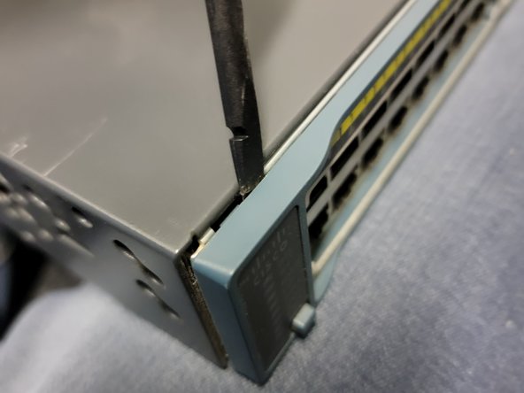

  6. Cisco Catalyst 2975 network switch cooling fan replacement, Remove face plate with spudger: stap 6, afbeelding 1 van 3 Cisco Catalyst 2975 network switch cooling fan replacement, Remove face plate with spudger: stap 6, afbeelding 2 van 3 Cisco Catalyst 2975 network switch cooling fan replacement, Remove face plate with spudger: stap 6, afbeelding 3 van 3
    • Remove switch plastic faceplate with plastic pry tool or spudger. Once you insert the tool in one of the edges, you can twist the tool with enough force to pry it open with a twisting motion.

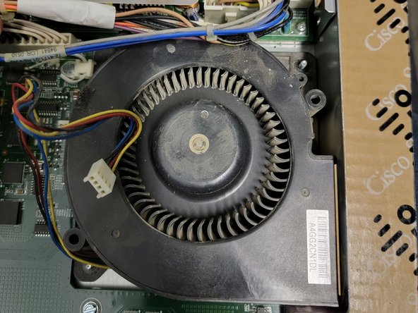

  8. Cisco Catalyst 2975 network switch cooling fan replacement, Remove cooling fan screws: stap 8, afbeelding 1 van 3 Cisco Catalyst 2975 network switch cooling fan replacement, Remove cooling fan screws: stap 8, afbeelding 2 van 3 Cisco Catalyst 2975 network switch cooling fan replacement, Remove cooling fan screws: stap 8, afbeelding 3 van 3
    • Remove hex screws on both sides corners of the cooling fan using a hex screwdriver. The each have small washers underneath them.

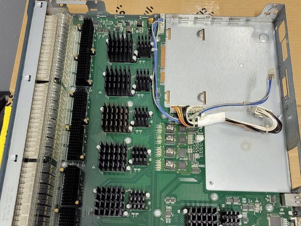

  9. Cisco Catalyst 2975 network switch cooling fan replacement, Disconnect power supply from motherboard (optional): stap 9, afbeelding 1 van 2 Cisco Catalyst 2975 network switch cooling fan replacement, Disconnect power supply from motherboard (optional): stap 9, afbeelding 2 van 2
    • Optional - for safety, I would recommend disconnecting both of the power cables from the power supply. You may need to cut the cable zip tie that holds the cable down between the fan and the power supply. Be careful not to cut any of the power cables.
  10. Cisco Catalyst 2975 network switch cooling fan replacement, Disconnect fan power cable: stap 10, afbeelding 1 van 3 Cisco Catalyst 2975 network switch cooling fan replacement, Disconnect fan power cable: stap 10, afbeelding 2 van 3 Cisco Catalyst 2975 network switch cooling fan replacement, Disconnect fan power cable: stap 10, afbeelding 3 van 3
    • Disconnect fan power connector from the motherboard by hand or with pliers.
    • Just for reference, the last picture shows the power supply and cooling fan removed.
