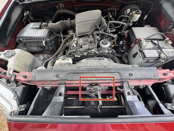

  1. 2020 Toyota Tacoma SR 4-cylinder Engine Air Filter Replacement, Engine air filter: stap 1, afbeelding 1 van 3 2020 Toyota Tacoma SR 4-cylinder Engine Air Filter Replacement, Engine air filter: stap 1, afbeelding 2 van 3 2020 Toyota Tacoma SR 4-cylinder Engine Air Filter Replacement, Engine air filter: stap 1, afbeelding 3 van 3
    • Pull the hood lever that is located on the driver’s side under the steering wheel to release the hood.
    • Move the secondary latch lever to the left to raise the hood.
    • Open the hood.

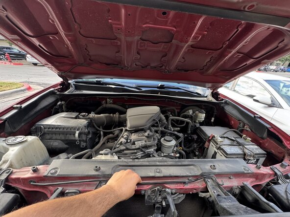

  3. 2020 Toyota Tacoma SR 4-cylinder Engine Air Filter Replacement: stap 3, afbeelding 1 van 2 2020 Toyota Tacoma SR 4-cylinder Engine Air Filter Replacement: stap 3, afbeelding 2 van 2
    • Position the hood prop rod into the mounting hole at the top of the truck’s hood.

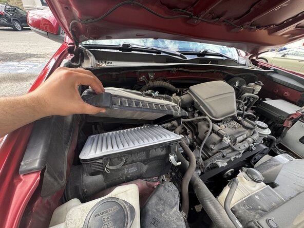

  4. 2020 Toyota Tacoma SR 4-cylinder Engine Air Filter Replacement: stap 4, afbeelding 1 van 3 2020 Toyota Tacoma SR 4-cylinder Engine Air Filter Replacement: stap 4, afbeelding 2 van 3 2020 Toyota Tacoma SR 4-cylinder Engine Air Filter Replacement: stap 4, afbeelding 3 van 3
    • Pull both silver clips upward from the bottom to release the engine air filter housing cover.
    • Pull the engine air filter housing cover straight up to remove it.
    • There are two sliding clips; be careful not to bend or damage them by pulling incorrectly.

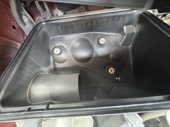

  6. 2020 Toyota Tacoma SR 4-cylinder Engine Air Filter Replacement: stap 6, afbeelding 1 van 1
    • Make sure the air filter housing is clean. If there is dirt or debris, remove it before installing the new filter.
