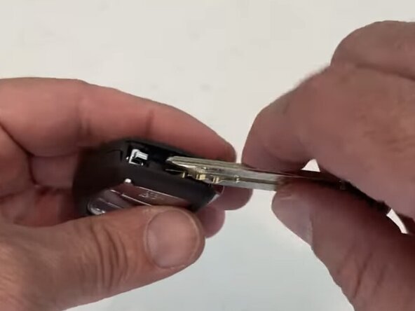

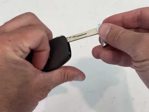

    • This step is crucial as you will not be able to open the case with the key inside.
    • Press the release button and slide the emergency key out of the fob.

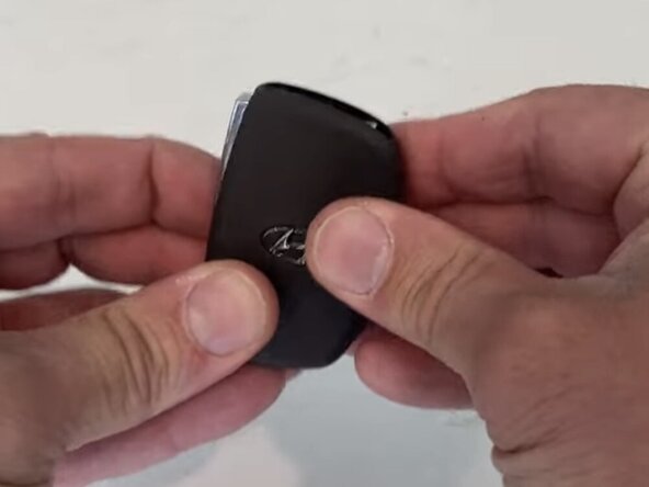

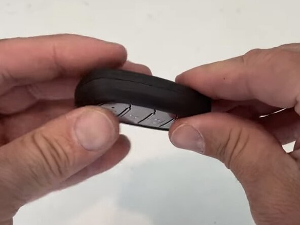

    • Insert the wide end of a spudger into the the bottom of the key fob and with a gentle twist, pry open the case.
    • Don't apply too much force or pressure to avoid damaging the key fob.
    • Once the case is open enough to get your fingers in the seam, use your hands to separate the top and bottom of the fob.

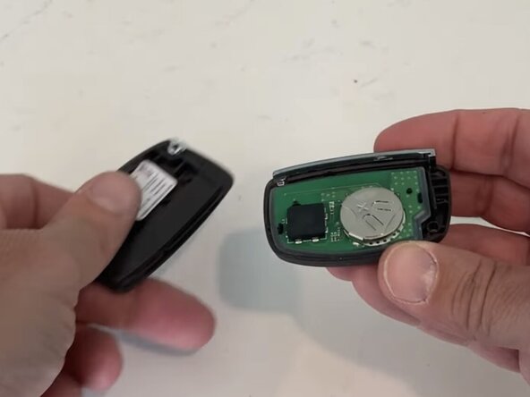

    • Use a spudger to remove the old battery from the holder.
    • Replace the CR2032 battery, ensuring the positive side ( + sign) is facing down.
    • Before you put the key fob back together, make sure the battery is seated fully and correctly.

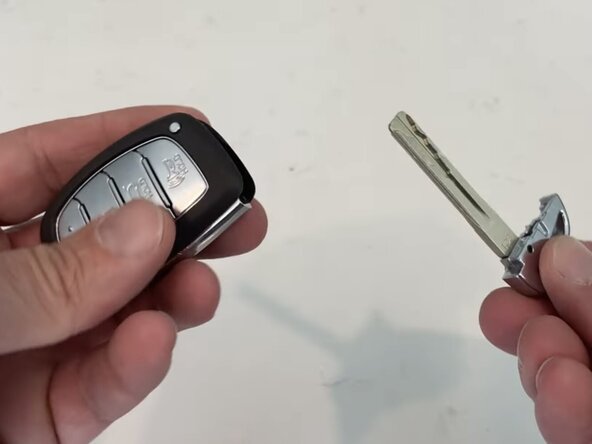

    • Align both halves of the case and press them together.
    • You should hear a snap when they connect.
  5. 2015-2020 Hyundai Elantra Key Fob Battery Replacement: stap 5, afbeelding 1 van 1
    • Slide the emergency key back into the holder until you hear a click indicating it's locked in place.
    • Give the key a test run ensuring all the buttons work and the vehicle responds accordingly. If not, ensure the battery is seated properly and try again.
