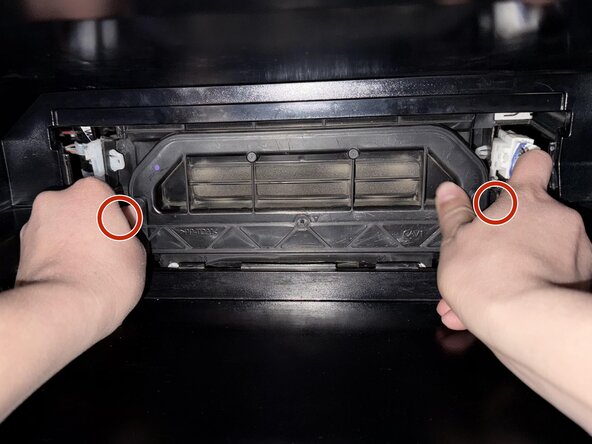

      • Let the glove box drop down to reveal the cabin air filter housing.
      • Push in on both sides of the filter housing to release the side stops.
      • Remove the housing cover and set it aside.
