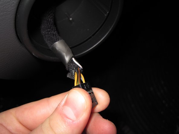

  5. 2004-2010 Volkswagen Touareg European Headlight Switch Replacement: stap 5, afbeelding 1 van 2 2004-2010 Volkswagen Touareg European Headlight Switch Replacement: stap 5, afbeelding 2 van 2
    • Remove the connector from the switch by depressing the release tab and pulling the connector out.

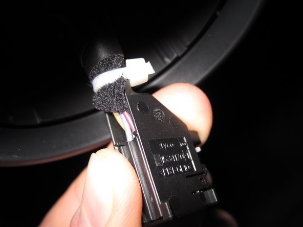

  6. 2004-2010 Volkswagen Touareg European Headlight Switch Replacement: stap 6, afbeelding 1 van 1
    • Cut the existing zip tie - the original one should be black.
    • Again, this pic was taken after the install was complete, so you're seeing the replacement white zip tie here.
  7. 2004-2010 Volkswagen Touareg European Headlight Switch Replacement: stap 7, afbeelding 1 van 2 2004-2010 Volkswagen Touareg European Headlight Switch Replacement: stap 7, afbeelding 2 van 2
    • Remove the connector from the housing itself. Do this with a small flat blade screw driver.
    • Pry up the locking mechanism and push the connector out of its shell.
    • With the right size screw driver, you can do this in one motion.
    • See the pics showing the housing (already separated from the connector) with the screw driver in place showing the right way to pry the lock open and push out the connector.

  10. 2004-2010 Volkswagen Touareg European Headlight Switch Replacement: stap 10, afbeelding 1 van 2 2004-2010 Volkswagen Touareg European Headlight Switch Replacement: stap 10, afbeelding 2 van 2
    • Slide the connector back into the housing and replace the zip tie you cut earlier.
