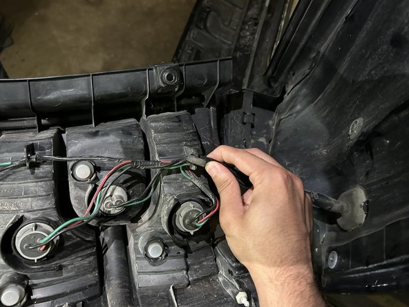

    • Gently remove the cables from their respective clips in the tail light housing.

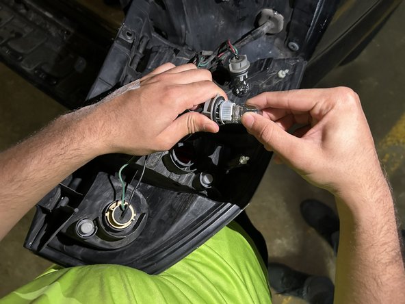

    • Pull the light bulb out of the socket.
    • Caution: The bulb may be hot if it was turned on recently.
  8. 2000-2006 Acura MDX Brake Light Bulb Replacement: stap 8, afbeelding 1 van 3 2000-2006 Acura MDX Brake Light Bulb Replacement: stap 8, afbeelding 2 van 3 2000-2006 Acura MDX Brake Light Bulb Replacement: stap 8, afbeelding 3 van 3
    • Replace the sockets with the new halogen or LED bulbs by gently pushing them into the socket.
    • Use 7443 type halogen or LED bulbs.

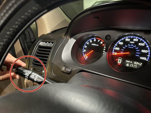

    • Turn on the car.
    • Ensure it's in Park.
    • Rotate the light dial to nighttime mode to ensure that the bulbs turn on.
  10. 2000-2006 Acura MDX Brake Light Bulb Replacement: stap 10, afbeelding 1 van 2 2000-2006 Acura MDX Brake Light Bulb Replacement: stap 10, afbeelding 2 van 2
    • Rotate the light dial back to daytime.
    • Push the brakes down to ensure the brake lights work when activated.

    • Gently place the cables under their respective clips in the housing.
