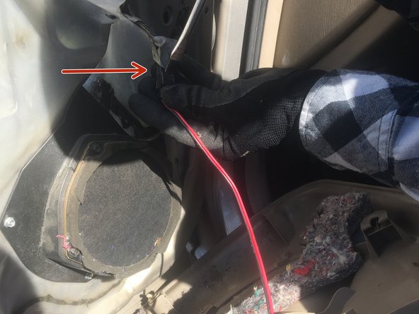

    4. 1999 Buick Century Window Regulator and Motor Replacement, Disconnect Necessary Cables: stap 4, afbeelding 1 van 2 1999 Buick Century Window Regulator and Motor Replacement, Disconnect Necessary Cables: stap 4, afbeelding 2 van 2
      • Tweeter Connection (circled in red)
      • Disconnect the tweeter connection where the red arrow is pointing.
      • Automatic Lock Connection (circled in green)
      • Disconnect the automatic lock connection from its location in the green circle.

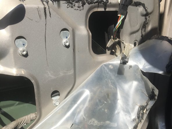

    5. 1999 Buick Century Window Regulator and Motor Replacement, (Remove Plastic If Applicable): stap 5, afbeelding 1 van 2 1999 Buick Century Window Regulator and Motor Replacement, (Remove Plastic If Applicable): stap 5, afbeelding 2 van 2
      • If the internal door panel is covered with protective plastic, remove it before proceeding.

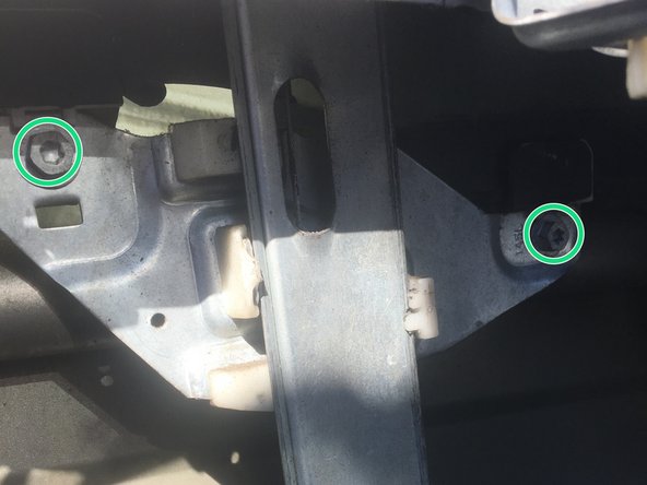

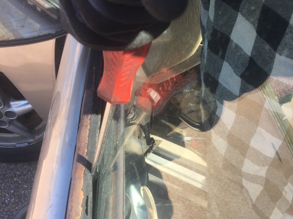

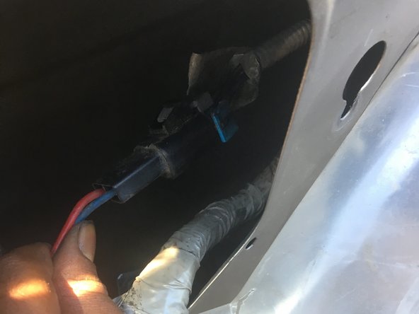

    6. 1999 Buick Century Window Regulator and Motor Replacement, Removing The Window Motor: stap 6, afbeelding 1 van 3 1999 Buick Century Window Regulator and Motor Replacement, Removing The Window Motor: stap 6, afbeelding 2 van 3 1999 Buick Century Window Regulator and Motor Replacement, Removing The Window Motor: stap 6, afbeelding 3 van 3
      • Locate and remove the 3 screws holding the window motor in place (Wrench and 10mm socket needed).
      • Disconnect the window motor connection wiring.
      • Wedge in-between the outer shell of the door and the window to hold the window in place (be careful not to damage the window. May have to stick it in at an angle).

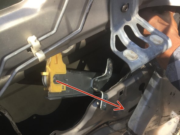

    7. 1999 Buick Century Window Regulator and Motor Replacement, Removing The Window Motor (cont'd): stap 7, afbeelding 1 van 3 1999 Buick Century Window Regulator and Motor Replacement, Removing The Window Motor (cont'd): stap 7, afbeelding 2 van 3 1999 Buick Century Window Regulator and Motor Replacement, Removing The Window Motor (cont'd): stap 7, afbeelding 3 van 3
      • Locate and Remove the four 10mm screws below the interior door latch.
      • Locate and remove the two 10mm screws on the window frame.
      • Remove the motor and the regulator through the hole.
