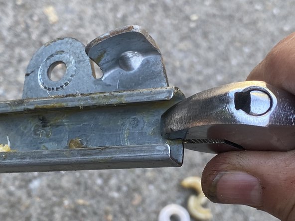

    4. 1994-1999 Subaru Legacy window bushing replacement, Bend Rail to Accomodate Bushings: stap 4, afbeelding 1 van 2 1994-1999 Subaru Legacy window bushing replacement, Bend Rail to Accomodate Bushings: stap 4, afbeelding 2 van 2
      • There is a tab bent into the rail on the rear-facing side to keep the bushings from sliding out.
      • Use the small crescent wrench to bend the edge of the rail until I could slide the bushings in and out.

    5. 1994-1999 Subaru Legacy window bushing replacement, Install Bushings on the Regulator: stap 5, afbeelding 1 van 3 1994-1999 Subaru Legacy window bushing replacement, Install Bushings on the Regulator: stap 5, afbeelding 2 van 3 1994-1999 Subaru Legacy window bushing replacement, Install Bushings on the Regulator: stap 5, afbeelding 3 van 3
      • Lower the regulator mechanism all the way.
      • Use channel locks to force the new bushings onto the window regulator.

    6. 1994-1999 Subaru Legacy window bushing replacement: stap 6, afbeelding 1 van 1
      • Move the regulator up a bit to get enough clearance.
      • Slide the rail onto the new bushings.
      • Lower the regulator all the way down.
      • Use the small crescent wrench inside the door to bend the metal tab back up once the rail is in place on the regulator.
