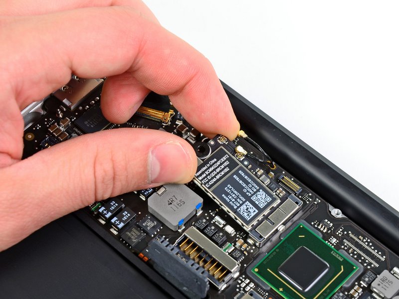

  4. MacBook Air 11" Mid 2012 AirPort/Bluetooth Board Replacement, AirPort/Bluetooth Card: stap 4, afbeelding 1 van 2 MacBook Air 11" Mid 2012 AirPort/Bluetooth Board Replacement, AirPort/Bluetooth Card: stap 4, afbeelding 2 van 2
    • Use the flat end of a spudger to pry both antenna connectors up from their sockets on the AirPort/Bluetooth card.
  5. MacBook Air 11" Mid 2012 AirPort/Bluetooth Board Replacement: stap 5, afbeelding 1 van 1
    • Remove the single 2.9 mm T5 Torx screw securing the AirPort/Bluetooth card to the logic board.
  6. MacBook Air 11" Mid 2012 AirPort/Bluetooth Board Replacement: stap 6, afbeelding 1 van 1
    • Slightly lift the free end of the AirPort/Bluetooth board and pull it out of its socket on the logic board.
    • To avoid damaging its socket on the logic board, do not excessively lift the free end of the AirPort/Bluetooth card.
    • Remove the AirPort/Bluetooth board from the Air.
